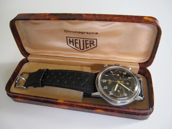

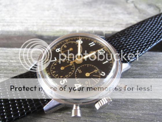

    I have a similar model Heuer from the same era but with a different movement - note mine has 3 registers instead of 2.
    Here is my model 2447 from around 1951/2
    [​IMG]
    [​IMG]
