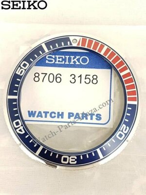

I have Pepsi with no lime pipIngen som sitter på ett pepsi insert till SKX, samt lite Samurai-visare & samurai-länk/gummi?
Behöver fräscha upp ett bygge!
Oooh? You looking to part with it? Pictures!I have Pepsi with no lime pip![]()
I just left for our Villa, but its OIM 009 insertOooh? You looking to part with it? Pictures
Its yours if you need it, but with PostNord it might take a whileI just left for our Villa, but its OIM 009 insert

Might be tricky to get a lume dot if thats what you mean by lime pip haha! Not sure how that works on the OEM insert, looks like its inserted directly to the bezel after insert is glued on?
Yes, i gotta order some stuff anyway so might aswell find something interesting. Dream would be to get a hold of one of these:Yes I am in Finland. Never had to glue one but I asume its not that hard. Anyway I recon go for the Ceramic one if the watch is a keeper. It elevates the watch nicely.
