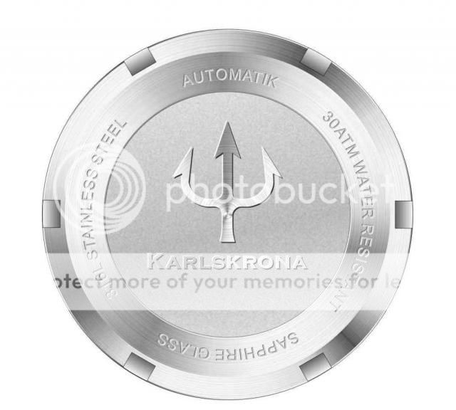

Karlskrona Watch Company dive watch project
I am playing with the blue pantone color. I'd like to hear input on the current color, a more subdued blue or... a more vibrant blue a la the Swedish flag?
Spontaneously I would go for the vibrant blue but all comes down to what kind of blue, what shade of blue we talking about.

I really like your effort and I think the white one looks really nice!
My input would be to make the numbers in the bezel slightly smaller an less Rolex-looking. And also change the crown back to the older version - also less Rolex-looking. The trident in gold looks nice!
Overall; good job and good luck! :)
